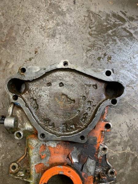

Back into the garage it went . I found the aluminum timing cover had disintegrated over the last 58 years . Geez , you’d think stuff would last .

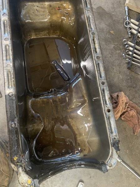

As I was cleaning the front of the block for the new gasket I dropped a scraper and somehow it magically went into the oil pan ! Off came the starter , centerline , oil filter and finally the pan . Nothing else can go wrong can it ?
are you sure that cover is aluminum? I kind of looks like cast iron, to me.
but to answer your question, expect failing freeze plugs. if the car was stored wet, and there is the damage we see to the water pump housing, if that was caused by the wet, expect one or more freeze plugs to fail when it pressurizes. Sometimes, you can inspect the freeze plugs and look for any that are "weeping" and I would replace those preemptively. Sadly, some freeze plugs are nigh-impossible to replace with the engine fully mounted to the K-frame.
Yeah, some days are like that. Time to take a break and go do something fun, or at least not involving your car for a few hours. We all have had things go wrong and they are what makes us better mechanics. For instance, I'll bet if you ever have to do that job again, the first thing you're going to do is pack a big, old towel inside the front of the pan.

I very carefully reinstalled the oil pan with new gaskets and started reinstalling the brand new shiny timing cover . Sure is pretty . Yeah , so much for that illusion . Seems the cast in timing marks in the replacement cover won’t let the harmonic balance be fully seated . Is it permissible to grind off the marks ? . Yes the block is a 318 Polyhead . What is rather strange is I’ve read several places that this block has an extra hole that the LA block doesnt and it needs to be sealed . This block doesnt have that extra bolt hole on the drivers side . Down the rabbit hole we go .

What's the diameter of your balancer? I'm thinking an LA balancer is on your future.. but I haven't done any of these poly/LA conversions
La318 from a 70 D400. I assume original. I assume it was made of cast iron because the engine uses a motor mount off the timing cover rather than off the ears on the side
