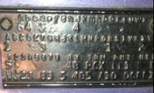

Can you decode this??? its suppose to be a 67 coronet R/T

I am having problems trying to decode this…
Is this a real R/T??
Can anybody give me the correct decoded info???
Thanks again for your help!

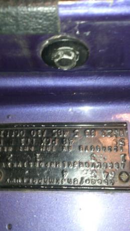

Yes. The WS23 tells us it's a Coronet R/T hardtop.

If I could tell what the lower numbers are I would love to. I need the practice
I think $22000 is more than a fair price. But you've obviously seen the car in person so you would know better. Barring any huge defects and If a true r/t, I think what he's asking is fair.
I came up with: Dodge Coronet R/T 2 Door Hardtop, 440 cid 4-bbl HP V8, 3-speed automatic, 7.75X14 Read Streak Tires, October 10 build date, Vinyl Split Bench Seats, that was pretty much from the bottom line, some of the codes above that and a couple more - hope that helps...

the engine is a C440 5 23 hp but the build date on the car is october…I was doing research and in 1967 and earlier, they don't have "numbers matching" as dodge didn't stamp the numbers on the engine..just the build date
Im obviously a newbie, but i have another question…is the fender tag number that starts with the ws23 suppose to match up with the vin number that is on the inside of the drivers door?
yes, WS23 Is the first four of your vin. WS23 a coronet R/T, think I posted on your other question, about non numbers matching, I didn't see this one. 21K for Non matching? I don't know. I just sold my brothers matching 67' GTX beautiful car for 24K. It was fairly priced. True, Chrysler didn't put the vin on the engine in 67', but that engine build date should be very close to the car date, and not after the build date. If it is after, clearly the car doesn't have the original engine. that fact does
Influence its value.My GTX's(2) both have dates on the block of 10 days prior to the scheduled build date or less. My brothers was 9 days. My 67' Chrysler
440 is 3 days prior. So I don't recommend paying the price of a real original for one that Isn't. I wouldn't, and other 67' experts
wouldn't either. Just be cautious, and keep asking questions!
