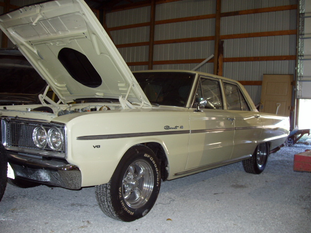

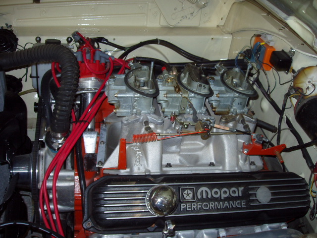

You have a copy of my Brothers Coronet 440 in 1967! It was a 383 four Barrel column shift, copper in and out. That is why I like mine so much, as I couldn't find a Coronet like that. I personally don't care if the engine is the same week or the same month, the engine doesn't know any better. Unfortunately some people see these cars like a rare piano or something, and want the rarest of the rare in order to
have something special,so they pay more to say they have it. My 69' Cuda has a 68' 383 engine in it, and it matters
not at all to me. I love that car all the same. I even put full wheel covers on it to bug the hotrodders.
If I want to confuse them I pull the 66' Coronet out!
