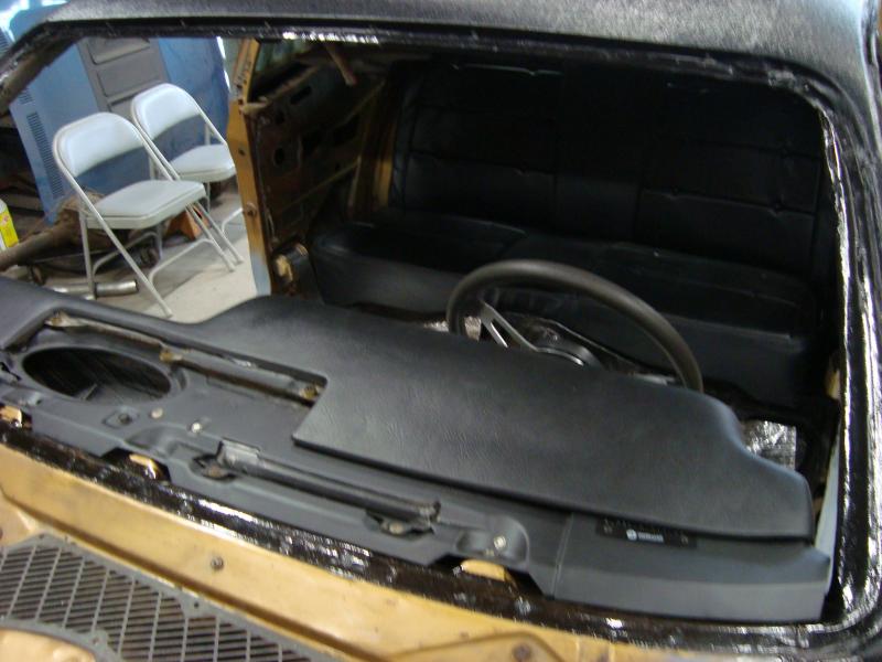

77.jpgyep 1/4 u joint long extension for me best to have a helper for the top ones if paint is fresh. here is a shot with the window out it shows what is under the speaker cover and the shitty dash cap fit!
