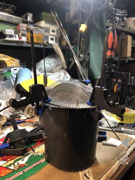

Then as pictured I made a metal screen dome shaped so the vent flapper would function correctly. NO MICE, NO leaves.

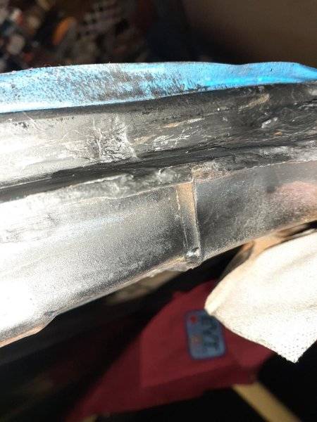

as i installed classic air system i sealed off the opens on the driver and passenger side on the inside and closed off the cowl so no opening to the inside from the cowl.
Guys tell me where to put sealant based on your best estimate
I laid glass bedding compound in the lower cowl channel, up the a pillar sides. And I added some in the gasket where the windshield sits. I did have extra ooze out so it needed a cleanup. But it is leak free. I did it myself without any help.

As mentioned before, I built a domed fine mesh screen on top of the vent box, still allows the door to open and close. keeps mice and leaves out. Can always blow the leaves back out the top.

I did the same with the hose on the shop vacuum. On my GTX the fresh air cutout in the cowl needed replaced. A fabbed one was welded in and as a sealer, I poured Silverbullet around the base of it. Stuff will stick to anything.

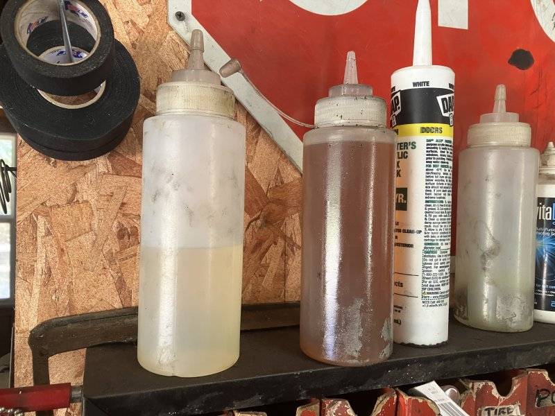

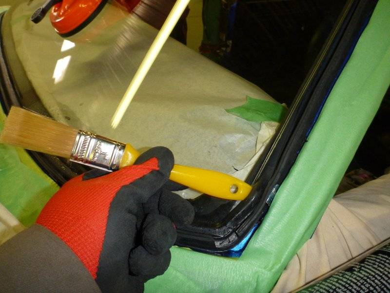

Kern Dog if you can tell us the manner he used the linseed oil did he wipe it as he went or did he brush it in the glass channel as we would glass cleaner ?
He used something like a mustard bottle similar to this:
He just squirted it in and set the glass in the bottom. He went from the bottom UP like I have done.

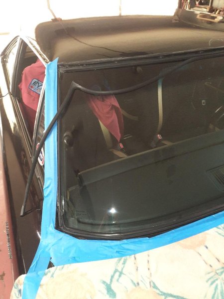

When I had the gasket installed with fresh glass from AMD on my 68 Satellite, the shop that did it said they sometimes use a hair dryer heat gun at the final 2 corners to assist final fit. Anyone else use this in addition to the lubricant (linseed oil, detergent)?
They also mentioned that some repro gaskets fit tighter than others.
thank you Kern i wanted to be sure . i have done this 3 - 4 times for these style cars so this will be hard as always but the linseed oil will be better as you and others have said hear lube is your friend so the linseed oil and take your time i will get it done.

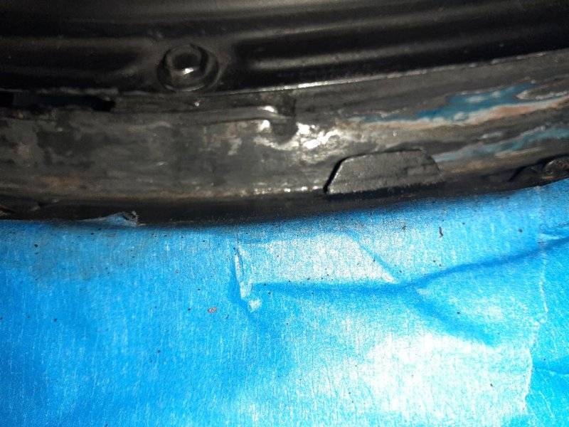

ok got the glass out and found rust where rust should never be. and the bedding some how did not seal so time to clean and start again.

i see some declamation of the glass very small at the right Conner and at the bottom in the center of glass. and the left lower along the bottom what you think ?
ok 2 spots first right a pillar factory did not set together the top and bottom together right. the left was tight so i filled with ultra black silicone.

second around left and right lower a pillar to dash opening i will close with ultra black silicone sealer as i know it will seal to the left of the dash bolt filled to end of dash .

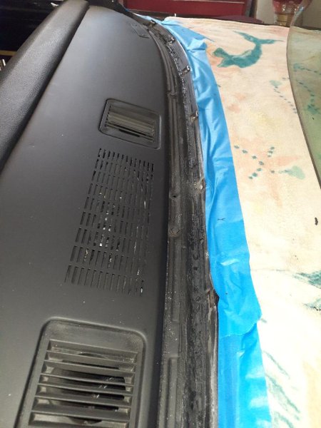

i also filled the 2 spots Kern dog showed . the 2 big openings that the dash meet the windshield frame and the gasket guider on the bottom 3 of them with ultra black silicone.
ok hear are the pictures of sealing the dash and other openings . not a lot just enough to seal water out im working on adding instillation on the roof . so when i get the head liner back in i will do the windshield.

ok i got the glass in my hands are sore today . i used 2 trim tools to work the gasket over the glass started at the bottom and 3 inch up the sides . the top corners seemed high so i started in the middle top and worked the rubber to the right and left i got the right corner then finished the right side then the left this took the longest and most work i read the manual and followed the install except i went bottom up then top middle and then the lock i used wind=x i was afraid of the linseed oil sorry no pic's i was into the work i will say dads bee install pick's helped a lot and thanks Kern dog for this thread.
