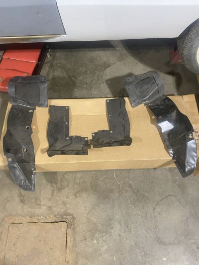

Hi. Helping a friend who inherited '67 Coronet R/T 440 HP. We are going thru the parts and don't know what these are or where they go. Car was completely disassembled by someone else.
Thanks everyone.
Arne

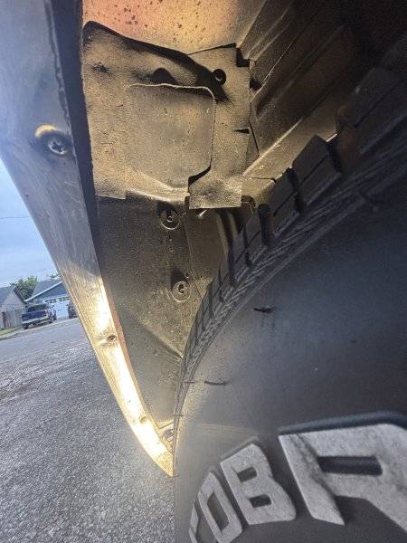

The bigger parts inside the fender. I can look in the morning at my 67 Plymouth where the smaller ones go. Edit splash shields the name.

The pictured items are the inner splash shields for the front fenders. The larger shields mount at the rear inside of the fender in front of the door jamb area. The smaller shields mount in the upper front inside of the fender behind the headlight area.
