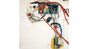

Breakers for that tap?? ---We need no stinking breakers.
Or the panel is full--Whats a guy expected to do?

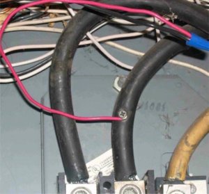

You guys are very good! Here’s another one for you. See anything wrong here?
1. Mixed metals on the stud bar - never use zinc studs on a copper or brass stud bar.
2. Appears to be a reverse polarity connection....given that blue is the International colour for a neutral wire. If that neutral is tied to earth (MEN system), you're in for fireworks. :D
3. Should always have either a double nut or nut plus spring washer on the studs. One thread of a single nut doesn't cut the mustard.
How many things can you do wrong in one picture? Lol

Is that @Bladecutter with those cables going between his legs??? :lol:
Just for reference-
Our neutrals are white.
Black, red and blue are the 3 phases in a "non 3 phase" 240 system, if you know what I mean,

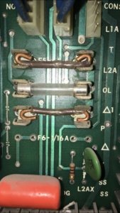

Time to fix these two stupid fuses that keep blowing all the time, once and for all!
