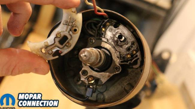

abodyjoe on the a body site in the electrical and ignition tab shows how to change an ignition switch on an a body. He does the turn signal switch at the same time. He has a lot of pictures of what order of things you need to remove.

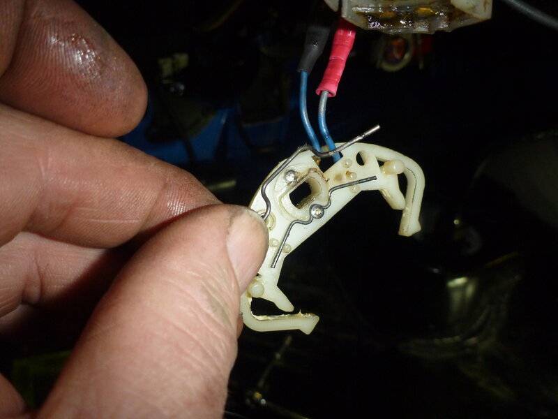

As I see you found in another thread Bill, my repair cam (and "good" old stock at that) lasted 5 actuations before it fell apart. Forcing me to tear everything apart again and I bit the bullet and found an NOS assembly to do it right the second time.

That one from O'Reilly's looks like it might have larger rivet heads holding the contact wires than the one I had. For $10 I'd grab one and see how sturdy it's held together before pulling anything apart.
Yes I read your thread. I'm getting 50 50 on whether this is a worthy effort. The slant 6 Dan switch should last awhile. I was just thinking about refurbishing the original as a back up.
Turning switch is broken on the cancelling tabs anyway so it worths the try. Now, about the brand! Who knows. I think the quality on these shouldn't be hard to check visually.
