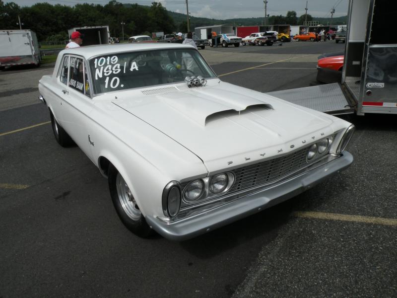

I went from 4.56's with a 29 x10.5 slick to 4.10's and picked up mph and Et. .15 to be exact and 4 mph
in this sled. 10.20 to 10.06 and a best of 9.96
