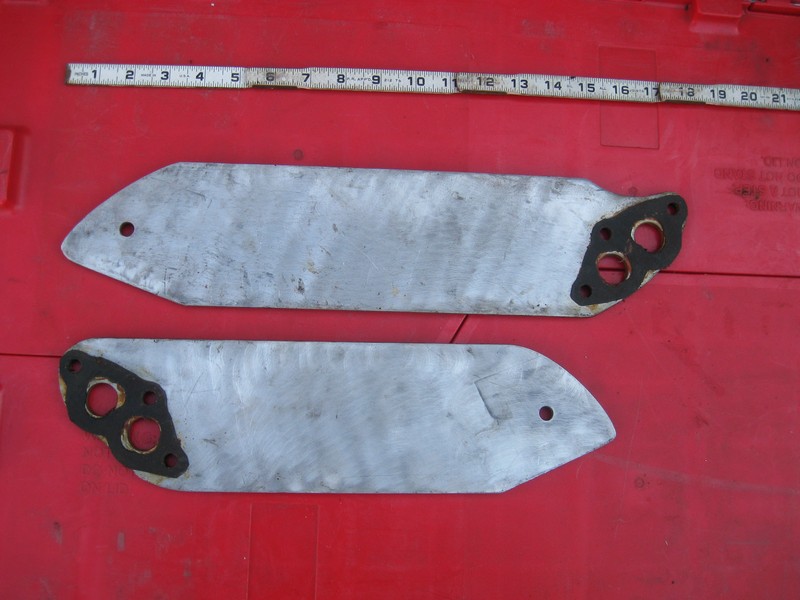

Just happen to have a set of elephant ears,,,,,,,,,
Ya I don't think anyone makes Hemi conversion mounts for the 73-up K-frame. Probably going to have to fab some up.
I guess I'd better start practicing my welding skills then.
