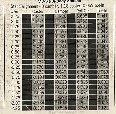

The higher the front ride height, the LESS caster you can get. These suspensions are designed as such that as the travel nears the full compression (As low as the car can be) the caster is at it's greatest amount. See this chart:
This is an alignment graph of a 73-76 A body but it is close to what a B or E body would have. The -2.25 is actually rise/extension....essentially 2 1/4" over stock height. Note that the caster starts at 1.77 degrees at 0.00. (Static ride height) 2 1/4" lower than stock, the caster sits at 4.892 degrees.
My point is that a car that sits higher than stock will have trouble obtaining enough caster. A car that has zero camber will have trouble too. If your car has a profound rake where the rear is higher than the front, that will make it difficult too.

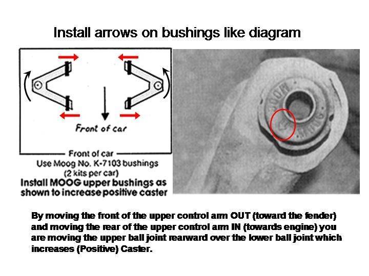

Don't know if it's been mentioned, the offset bushings come with instructions... Throw them away, they won't accomplish what you want... The bushings are intended to change the camber... We don't use them for that, we install them to change caster....
There are lots of drawings & pictures of how to install them for caster posted on various sites.... I don't waste my time... Just know one bushing is installed with the arrow pointing inward & the other points outward... Now, look at your upper control arm & know you want to move the ball joint as far rearward as you can...
When I install the arms back on the car I install the eccentric bolts to push the upper ball joint even further rearward... That way when the alignment guy gets the car you can tell him you've already maximized caster & he needs to keep as much as possible while getting camber in the .75-1 degree negative range....
Kern is spot on, .75 rarely shows wear but I'll push it to 1 degree and trade a little tire wear for better handling cause even driving as much as I do which is more than most classic car owners I find the tires are usually out of date & need to get replaced long before they wear out...
This pic is what they've shown on how to install.

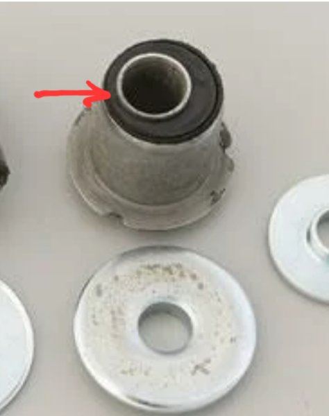

I'm wondering about the lack of material on the one side when using the offset bushings. Will they last as long as a standard bushing? Do they bottom out on that side? I don't think there's much weight exerted on these bushings but curious about their longevity.
