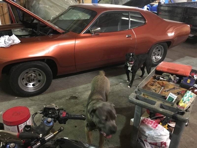

my72 satelite shuts off when I put it in gear . I checked for vacuum leaks, can’t find any ??

Cool car but to help we need some more information (at least I would)
