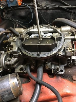

I have a Carter AFB on my 383. It seem to be getting too much fuel as I get a light dusting of soot on the ends & sides of my tail pipes, they are straight out the back. I also get it lightly on the bumper. There are 2 screws on the front of the carb, what are they for? Can they be adjusted to fix this or do I need to open it up and change the jets or something?

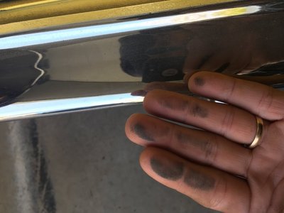

No im getting soot on the sides of the tail pipes, the bumper, the rear panel where the tail lights are. Quite a bit too. If you rub your leg along the bumper it will be black.

The two on the front are your idle mixture screws. They are effectively bleed screws, and what you are adjusting is how much air you let/don't let in.
The idle speed adjustment is the one on the side.

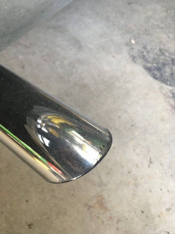

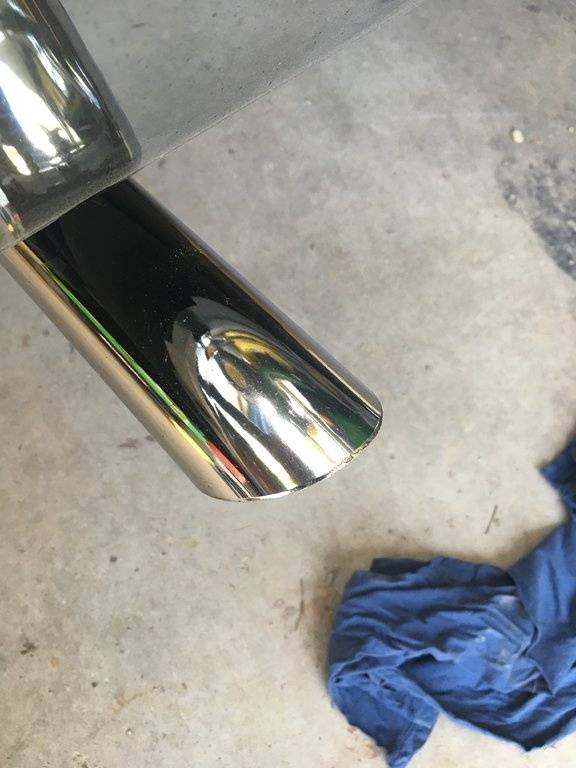

Here are some pics of the soot, although its kinda hard to see on the bumper in the picture. I wiped my hand along 6-8 inches and the tail pipes is one dirty and after wiping with a rag. I likely drove for 2 hours that day.

Are you sure that not just left over oil from before the valve stem seal change?
I have probably put 100 km or more on it since the seals were done. I guess it is possible though Mark.
