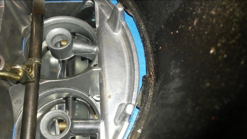

I have a 68 coronet. I'm putting a 383 in it. I have a 69 n96 dual scoop hood i'm using. From what i've read in previous threads, the only intake that will work for hood clearance to the air cleaner top is the factory one. I would like to know if i'm limited to using the original carter style carb, or if something else ( better ) would work with a 68 383 stock intake ? I'd like to use a good 750.

A Holley 750 dp is the first thing i tried. I discovered it doesn't sit flush on the intake. Is cutting the intake to allow it the " tinkering" you refer to ?

I guess I'm not sure what the issue is. My Holley & Carter carbs are the same height. Not sure what you mean by "sitting flush" on the intake.

I've been down this road. I've run a 383 4bbl, 440 4bbl and 440+6 in my car, all with N96. The 383/340 N96 bases are roughly 1" taller than the 440 4bbl bases. I believe the 440 sits roughly 1" higher in the engine bay. You have about 1/2"-1" clearance between the air cleaner & N96 hood to play with. I "think" you've got a little more clearance with the '70-'72 style "round lid" N96 air cleaners vs. the big oval '69 ones. I tried a few aftermarket intakes on a 440 4bbl and nothing would clear, even with no carb spacers, except the stock intake. I got a 750 vac secondary 3310 Holley to fit just barely with a stock intake by grinding away (1/8"-1/4") on one little part on the end of one of the throttle plates & by grinding about 1/8" off the side of a stock intake right above the hole for the choke, on the side of the intake, right beneath where the carburetor sits & then the Holley sat flush on the intake. IF you can squeeze in a 1/2" carb spacer, you wouldn't need to grind the carb/intake to run a Holley. I didn't try it, but I'm 99% sure that Carter/Edelbrock carbs will sit flush on the intake with no modification.

Thanks man ! The part on the throttle body needing ground off is EXACTLY what i meant by, it not sitting flush.

Just take a look and see how much of that throttle rod end part is blocking the carb from sitting flush. On mine, I was able to grind it away a little and I could tell by looking at it that the grinding wouldn't hurt a thing on the carb.

It will work with a li'l jury rigging. But the two aren't meant to fit together. The tabs on the base the air cleaner, which keep it aligned, are directly where the uprights are on the carb.instead of next to them .
