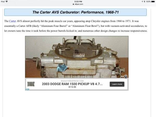

Sorry Bill, but the Carter AVS is a vacuum secondary carb. You can check it out here: https://www.allpar.com/fix/fuel/carter-AVS.html
I stand corrected my friend, the mechanism and operation is completely different from a holley in that when the secondaries start to mechanically open on the avs, it causes a vacuum on the air door which controls the amount of air coming in thus preventing a lean out before the fuel catches up....so you are correct as stated Sir.
