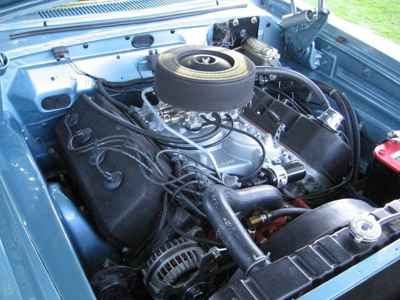

Nice...one of the original 350 six barrel,
Hmmm. What happened to it?
