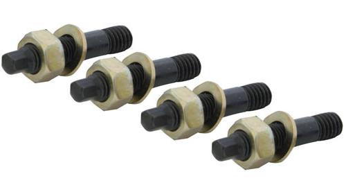

ARP is the premier company in automotive fasteners. However, the carb studs are not under a lot of pressure unless you are trying to pull your engine via the intake manifold which I personally would never do. Companies make carb studs that are about 1/3 the price or less and some like Mr. Gasket or Spectre have a hex top that makes installing the stud much easier. I've also seen studs with an allen head for installing.

I like the those and or if I can find a hex but would prefer them in stainless. Haven't searched for them as of yet.
