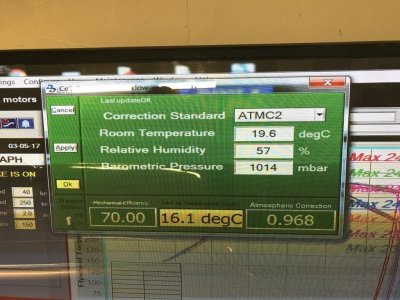

i don't think there is that much difference in weather between your weather and the middle of the u.s.a. i would be concerned with altitude more than humidity or temperature. i'd leave it alone, unless there was some kind of noticeable problem in the way the plugs are burning.
Lewtot,
I disagree....altitude is just one factor.....air density measured in pounds per cubic foot at standard conditions is the most important aspect which includes temperature, humidity and atmospheric pressure. These factors went into determining the carb's initial calibration.
If you suspect a rich or lean condition, read the spark plugs or use exhaust gas analyzer to determine mixture ratio....ideally 14:1.

i said read the plugs. air density/humidity is a factor everywhere; including altitude. the old factory specs stated re-jet wasn't a problem with stock engines until altitude approached 5000ft.
