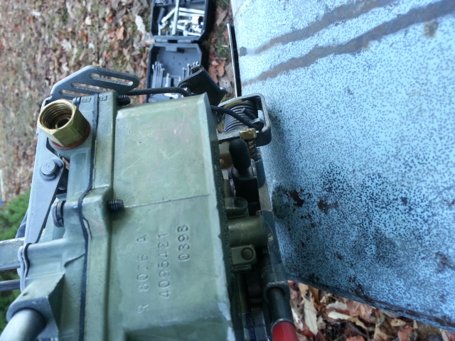

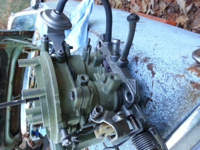

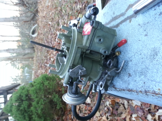

On this Cheap C7108 2bbl Autoline Holley Carb, I need some clarification on which lines connect to what.
- 1 on Pass side
- 2 Small ones on the back
- 1 Small under the carb at the Front

one on the side, towards the top, is for distributor vacuum advance. All the ones on the bottom (throttle plate) are manifold vacuum and are for any vacuum accessories. The larger tubes are for PCV and/or power brake booster. The fat one on the top, near the air horn is a vent for the fuel bowl. You shouldn't cap it off completely (I usually put a hole in the cap when it isn't connected to anything).
