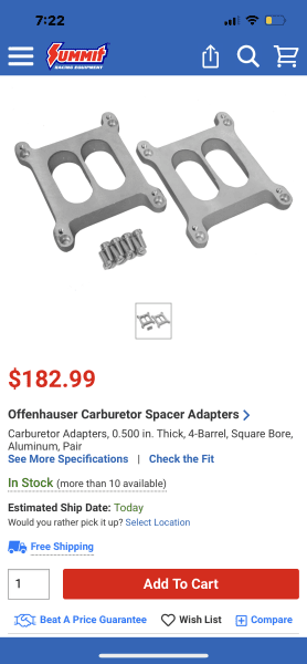

I have an Offy 5186 dual quad manifold
And want to confirm the carb spacers needed to mount a pair of Holley’s.
Is this what is required?

Check the carb to carb clearance. The manifold would have to have been designed to mount Holleys to have enough clearance for Holley float bowls. Few were.
Mike
If your manifold has the small square bolt pattern, then those adapters will not fit, without doing some drilling.

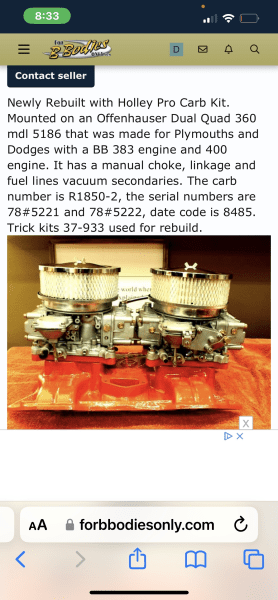

Making a clone of my dads car
Single 4 now but eventually two fours
It was a poly and then 383
Look at my post you can see a photo of the poly with two fours
