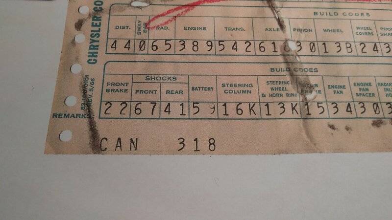

A good friend has a Lynch Road 67 Coronet 440 with a poly, or as the build sheet refers to as a "Canadian 318" with hydraulic lifters.
I'm not saying it is not an LA 318, but if it is, it is not the original engine. The other possibility is that someone put LA heads on your poly block.

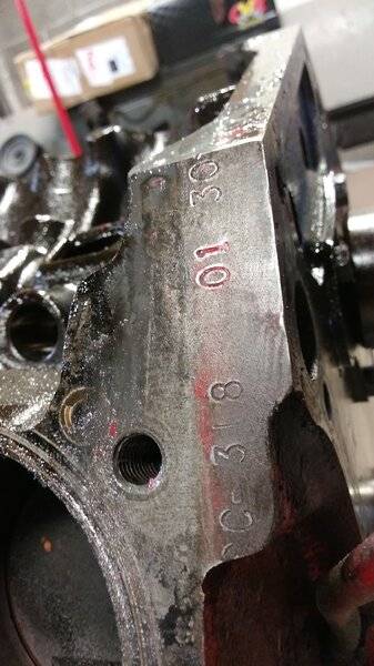

I was under the same impression. Cleaned off the area below the head on drivers side, no stampings. Turned out it was on the passenger side leading edge of the head, stamped CC318 (Canadian 67 series).

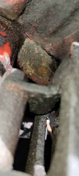

Cleaned it off and it just says 318, no other characters

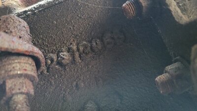

the block casting shows waht looks like 65 maybe 66
