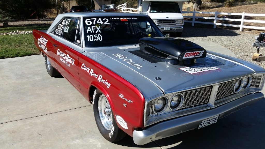

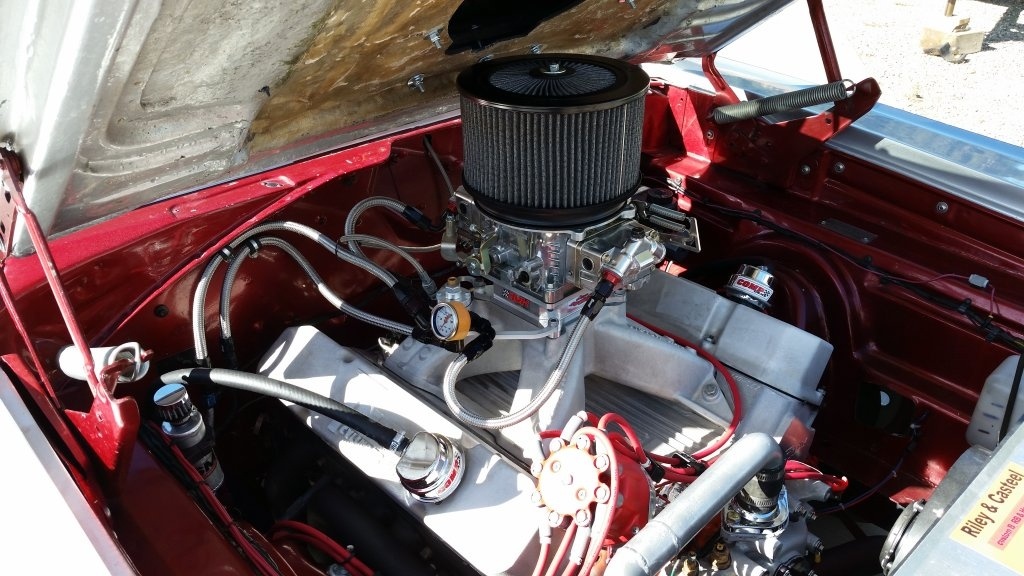

Doug
Here is what I setup for my car. Spectre intake fiberglass hood. So far works for me.

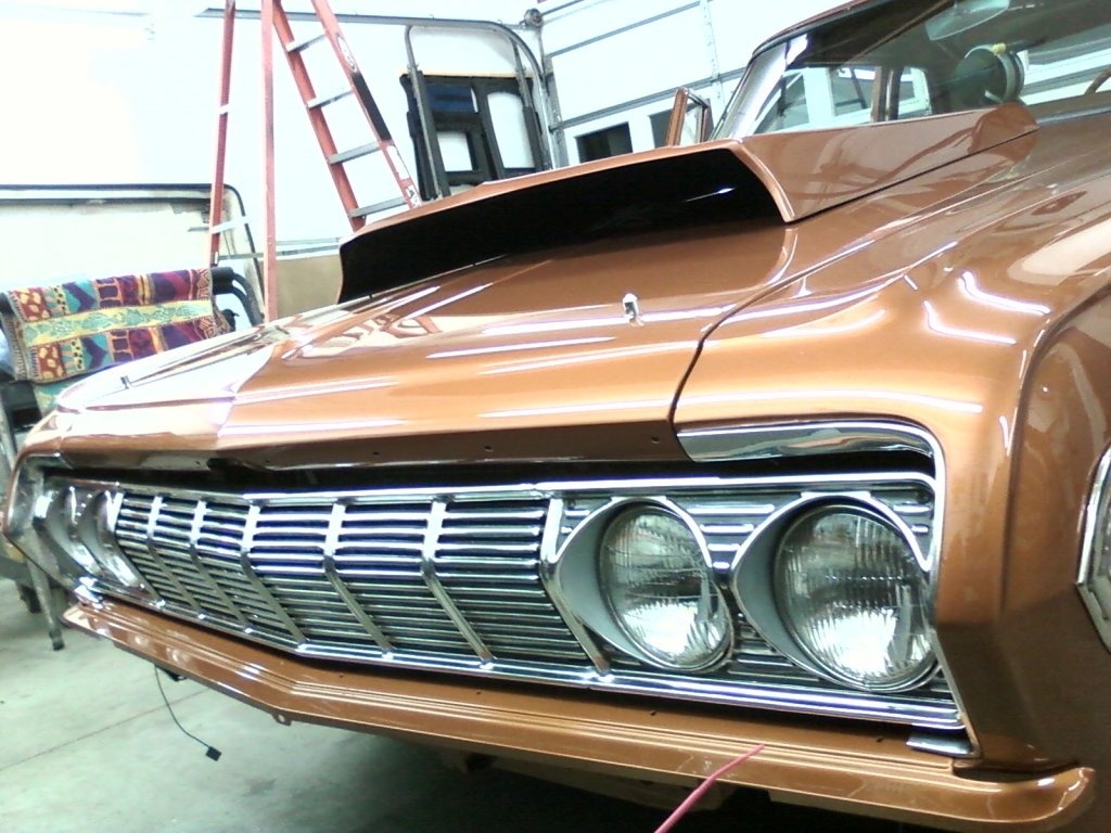

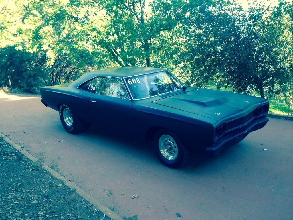

JR
If you are going to fab a sheet metal intake, then get a big hood scoop.
When I installed my Dominator with an HVH CNC 4150 to 4500 carb adapter I ran out of toom with my standard 66 Hemi Scoop.
This Harwood Scoop solved ALL of my clearance problems and even allowed me to run a big K&N Filter.

Mike LeFevre
The stud of my carb and the air cleaner come within about 1/2" of my scoop. You can see how little room the scoop gives in the middle as thats about all I have since the carb stud comes to about the flat surface of the hood. I have a 14" hole in the hood so I have some clearance. I use a solid steel eng mount and a chain on the drivers side. After reading this it now has me curious if it would run any better with more room. But it does run fine eng wise this close as it never misses once jetted right. Ron
