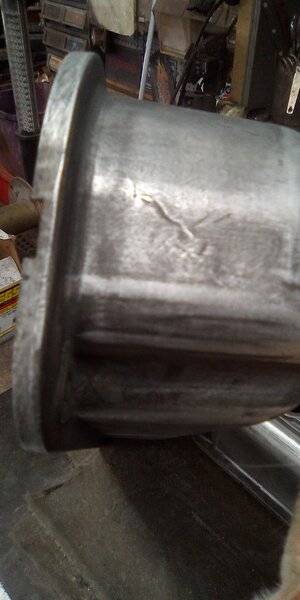

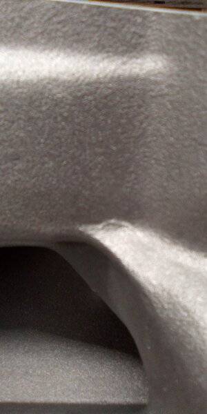

Keep in mind that narrow teeth are for steel and wider spaces between are for aluminum. Some appropriate wax is a good idea too to save them from getting gummy. I use mine every time I do bodywork on parts before moving to riffler files for the detail stuff.
