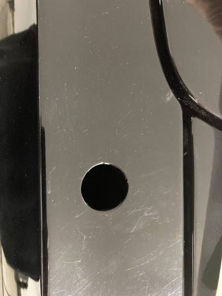

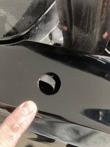

Hi there, don’t do much metal or body work so looking for what recommendations folks have for die grinder bits to enlarge my antenna hole. It was radio delete car that the previous owner put a radio in and aftermarket antenna. The hole is not what factory mopar antenna uses so I’m changing the antenna to stock and getting rid of the crappy aftermarket one.
fortunately the hole the made is near the stock location, I just have to enlarge it to fit the new antenna.
I can only think of using a die grinder or dremel like tool for this and would like recommendations on a good bit to use that maybe won’t create too much heat. I have both the die grinder and dremel.
‘’thanks!

Hard to see in the photo I posted where it starts behind the stencil. I’m afraid my skills on the metal tools is definitely not up to your aircraft making abilities! I wouldn’t trust myself to try the sideways shuffle on a freshly painted fender. YIKES!

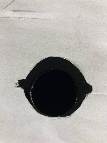

I ended up using a double cut carbide burr 1/4” x 3/4. Worked like a charm with light gradual passes. I etched the paint first to creat a sharp edge to prevent excess chipping etc…
the metal stayed nice and cool. I think a stone/drum sander would have taken a long time and created a lot of heat. Made a little bed of tape, sticky side up, to catch chips and filings from going into the bottom of the fender.
