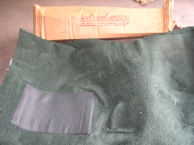

I think there are only 2 manufactures of the carpet for our cars. ACC and Trim Parts. If you are looking for a 4-speed dark green, I have a brand new set that I won't be using. pm me if you may be interested.

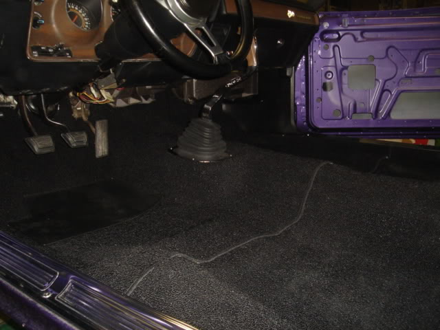

Did some more research and have found lots of happy customers with carpets from Motor Parts South. Here's a photo from another site. I'm ordering through them. They don't have a website, just a good 'ol phone # (shown above).
carpet
