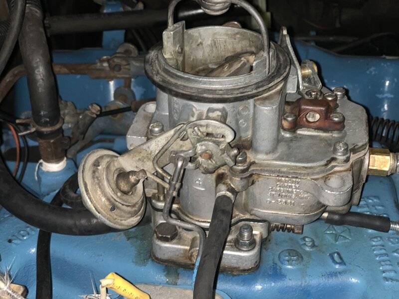

I concur that this is a 1-1/4" Carter BBD carb (vs a 1-1/2" Carter BBD on larger engines). Your first pix shows the ported vacuum advance connection with the small rubber hose connected, which should run to the distributor vacuum advance connection. This pix also shows a 1/4" or 5/16" bolt and a hose connected to a nipple. Typically, this is where the PCV hose is connected.
The first pix also shows the choke coil heater and its control switch mounted on tge manifold. Its purpose is to help heat the choke coil faster to open the choke faster and reduce emissions.

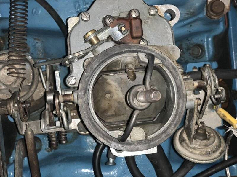

The idle adjustment screws are shown in the last pix. The screw closest to the carb body is the COLD idle adjustment; the one outboard of closest to the bottom of the frame is the hot idle adjustment.

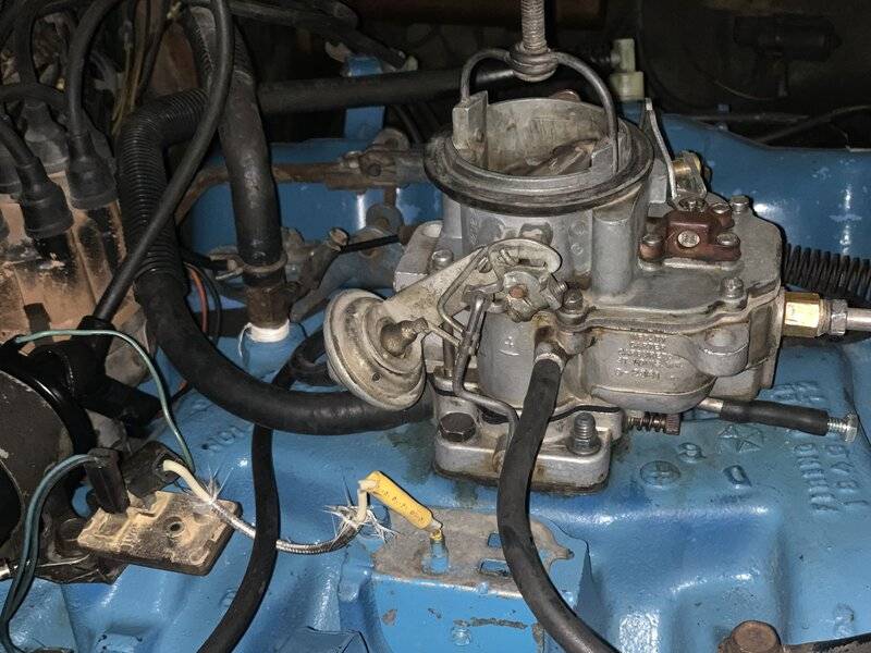

As 1973 was the first year for EXHAUST GAS RECIRCULATION (EGR), with the EGR valve shown in uour last pix, under the spring. IF this valve is stuck open, a poor, very lumpy idle will result, this valve is controlled by the carb usually thru a dedicated connection via a thermal vacuum valve that inhibits valve opening until engine reaches operating temps. Just a few more things to check.

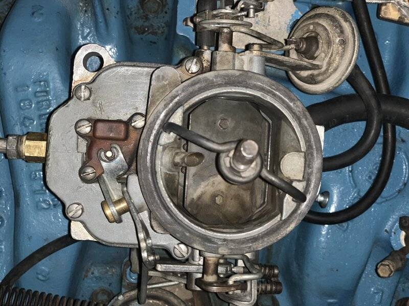

Toolmanmike might be on to something. In picture 2. One of the two screws in the bottom left corner will alter your curb idle adjustment. I’d start here with trying to tune in your Carter BBD. This setting should directly impact the amount of gas pedal pressure and ideally get you to a point where the engine idles with zero gas pedal needed.

Toolmanmike might be on to something. In picture 2. One of the two screws in the bottom left corner will alter your curb idle adjustment. I’d start here with trying to tune in your Carter BBD. This setting should directly impact the amount of gas pedal pressure and ideally get you to a point where the engine ideas with zero gas pedal needed.
