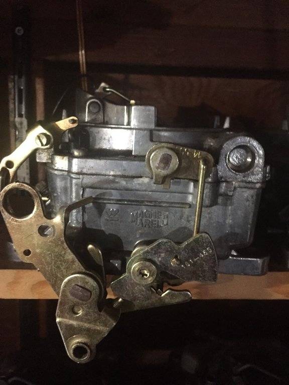

Where do I find reference to Magnetti Morelli on either of them?
I like the thunder series AVS. I have two 800's on my hemi. They are very simple carbs and easily adjustable. I like the fact that you can change jets and rods without getting fuel all over the place. Try doing that with a Holley.
Can you see it behind the linkage on the carbs main body?
There is a "W" on the left and
Magnetti Morelli over each other that is more centered.
