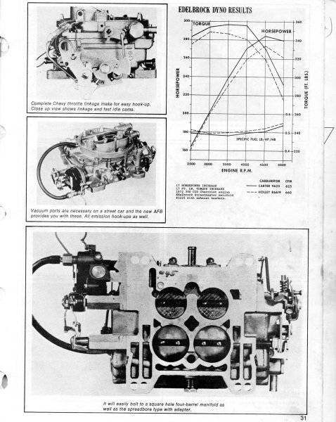

Carter 625 v Holley 600. From the Carter: 17 hp more, 17 ft lbs more & used less fuel doing it....
