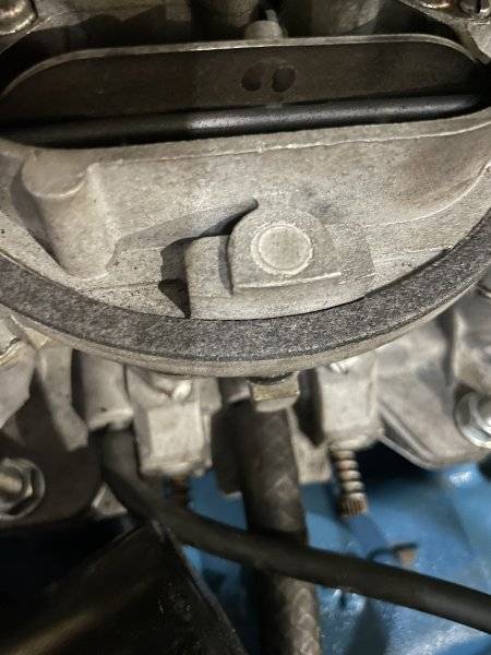

Something to consider with the Carter AVS 4737S 1970 GTX 440 4BBL carb. Because it's an emission controlled carb, in order for cleaner emissions, tge carb has a special OFF IDLE AIR BLEED festure. Whrn thd throttle is opened slightly, manifold vacuum opens a spring loaded check valve in the idle mixture passsge and additional air flows in diluting the idle fuel mixture slightly to achieve better off idle mixture and emissions. The adjustment is located in the front of the top air horn assembly and is underneath a pressed in cap. Removing this cap will expose an adjustable restrictor. To reduce the effect of the addional air introduced, screw the adjustable restrictor clock wise until it bottoms out, to eliminate the function. Count the number of turns required to bottom the adjustment to allow it to be returned to the original position if wanted/needed. By eliminating this addional off idle air bleed's function, the off idle mixture will be richer and will correct an off idle stumble condition. This change has nothing to do with the idle fuel metering source in the primary booster venturi assemblies or the position of the off idle transfer slot relative to the throttle plate position. Something to consider......i've done this several times and is effective.
BOB RENTON
Bo, I have seen that cap/plug. So removing that exposes the screw adjuster?
I did mention off idle bleed. It is not meant to be adjusted and that is why factory seal. Easier to plug the inlet port in the top to see if that helps. BUT the implication is the carb did work, then started to act up. So idle mixture and bleed along with cleanliness of the transfer port/slot would be where I look first.
Yes....carefully remove the cap...the treaded adjustment is underneath the cap.....
BOB RENTON
Pics? Under this circle? If so a small drill bit and pry it out? Sorry Im not trying to high jack the thread. It seems we have the same stumble.
The adjustment serves a two fold purpose. First, it controls the off idle air bleed function during initial throttle plate opening and second, it performs a deceleration enleanment function (adds air to the idle fuel mix), during coast down (closed throttle) to prevent an overly rich idle mixture and higher exhaust emissions during this condition.
