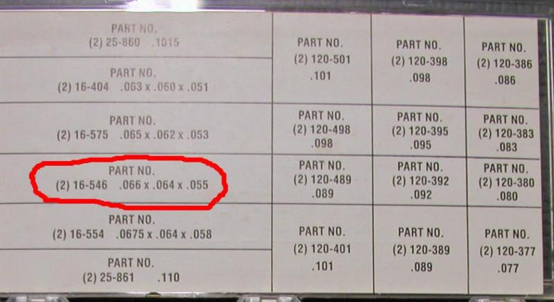

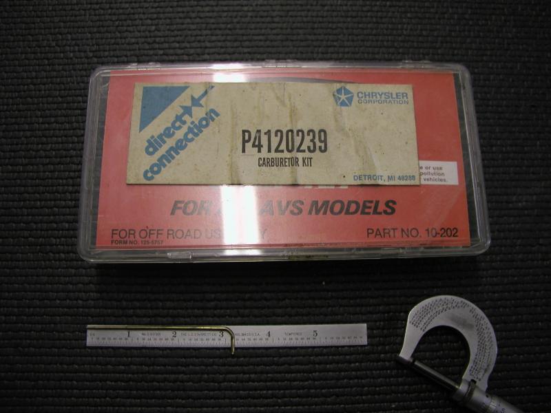

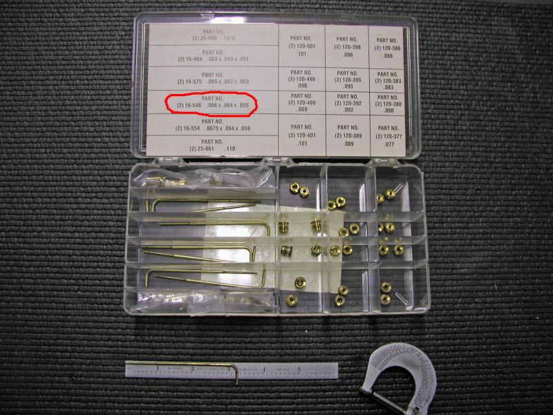

Thanks for posting Mopars & Missiles. That is exactlywhat I was looking for. I’ve also been looking for that 10-202 Strip Kit youhave. I am having trouble reading the numbers. Can you verify the numbers inyour kit are as follows? Or please post another picture.
Carter 10-202 Strip Kit for AVS carburetors
Rods in kit:
16-404 .063”x.060”x.051”
16-575 .065”x.062”x.053”
16-546 .066”x.064”x.055”
16-554 .0675”x.064”x.058”
As it turns out I have the 16-546 metering rods but they arenot marked. That is why I was trying to find the specs. The rods came out of aCarter 4734S for a 1970 383 AT. The 1970 service manual says the 4734 has16-546 metering rods and .089 primary jets. Also with there only being .001”between the 2 steps and the Service Manual calling it a 2 step rod I assumed itwas only 2 steps. So, I stand corrected. Depending on where you mic the rod lengthwise and how it is rotated you will vary by +/- .0005 or more easily. Plus I’mnot using new parts. Even so, I figured I should measure the rods and jets andcompare them to specs to see what I’m putting in there.
I’m trying to clone a 4426S from a 4635S that I have on hand until I find a good 4426S.
The link I posted says that they will sell the kit. Not in the original case but from nos stock and machined pieces.
