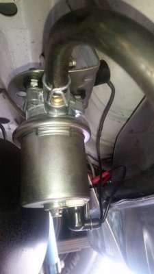

So just finished mounting new fuel tank, new 3/8" pickup/sender and new Carter P4070 electric fuel pump.
Worked great for about 15 min and pump decided to quit. Checked it over, seems electric motor is up the creek. Meter reads 20 - 30 k ohms and not steady.
Just chatted with Summit customer service guy. He reckons in 15 years there, he's never seen/heard one of these fail. Made me feel so lucky!? Oh well, he is sending another to me now.
My question -
I do plan on running a 1/4" return line with 0.050" orifice back to tank later. Is a return line a strict necessity with electric pumps or just a "nice to have" to prevent vapor lock? The Carter instructions do not mention a return line at all.

I ran an Edelbrock Street electric pump 150 GPH. Failed after years of service. Replaced it with same, and it failed after about 150 miles. Summit has never heard of this before. Carried a spare pump for years, then went back to Mo Mopar hipo mechanical pump. Quiet and reliable.
I have been using the same Carter pump for over a year now with no problems. I installed a pre filter before the pump and a regular fuel filter close to the engine.
I did not run a return line.
they'll stick sometimes. that pump will only do 3 or 4lbs psi. they're fairly simple. take the top cover off and see if the armature is stuck. sometimes it can be free up with some wd40. sitting for long periods of time will let the gas gum up the works. i'd recommend a carter 6903 mech pump.
You may want to check out your power source. It mat not be getting enough poop which will kill it. Learned that one the hard way. If its piggy backed on another circuit, it may not be sufficient enough and may need its own.
These guys make some good points. I think you just got a clunker pump. I ran a Carter for 7-8 yrs. without a problem & so far my Holley blue (5 yrs.) seems fine & I've never run a return line. I "think" return lines are only necessary with fuel injection & high fuel flow where the pump can pump way more fuel than the injectors need so the excess is sent back to the tank rather than "dead heading" the pump.

Tech guys always say that "this is the first time I've heard of that". Return line not necessary, pump only puts out low pressure (for carb) and a return line would only reduce the fuel flow at higher eng output. Have a pump just like yours and first one failed in short order also. Parts store replaced w/ no questions. I used a fuel filter off of an 80s era corvette (can't remember exact year) between tank & pump that has 3/8" in & out. Filter is about 3X the size of a std fuel filter. I figured I needed that to insure that no debris gets into the pump since I'm running an old tank. I'm also nervous about the pump and don't wander far from home. Planning on going back to mech. I have the pump running off of a relay that has full voltage from a reliable source. Also have an impact switch wired into the circuit to kill pump in case of collision. If interested I'll try to find the # of the Corvette filter. Think I have it somewhere.
Electric pumps are push pumps so keep as low and close to the tank as possible and as quoted check voltage at pump and ground

Pump suction is maybe 8" above pickup and 1" away from tank - Carter recommend no more than 24", and obviously less is better. I will be shifting/lowering new pump a few inches anyway to gain more clearance. Voltage is not an issue.
Been using Carter electric pumps for years on street cars and racers.Using it as a pusher at he tank to the mechanical pump.Only once did I have one fail right out of the box.(Nothing is perfect) I like to run a before pump filter and a after at the carb.Also on street cars,installed a switch(and relay) to prime the carb after sitting for days.Turn it on for full throttle blasts and off letting the mechanical do the job for regular driving.
I always run an electric pump on my cars. One thing is yes you want the pump as low and close to the tank as you can get it. And fuel under pressure being pushed up to the carb will not vapor lock as easily as fuel being pulled up to the fuel pump on the eng under vacum. Having the fuel being pushed under pressure will help fight vapor lock a good bit. I have never had any vapor lock problems at all and I drive on some very hot days. Now the only problem I had was this pump gas fuel wanting to boil in the carb fuel bowls if the fuel gets to hot as the cheap pump gas of today with the ethanal in it will boil if the fuel gets around 190 to 200 degrees. And when it boils it will make it run rich as on my Holley 850 it will boil the fuel to push out the internal bowl vents right into the carb throat. Buts thats a different problem then vapor lock as running a wooden or phenolic spacer under the carb is big help to fight fuel boiling. It sounds like you want to run a return line like the factory did with the 3 nipple fuel filter as the third line went back to the tank through a restrictor in the filter to let vapor push out the return line and go back to the tank. I dont remember the size of the restrictor but the .050 you said I believe is about right and if the stock mechanical pump can handle it the electric pump should with no problem as at that small size it dont effect fuel pressure or volume. Many guys do run stronger pumps today and run a return line that bleeds off enough fuel to keep the fuel pressure correct but you need the right pump and fuel pressure regulator to run that setup. It also helps keep the fuel cooler by having some fuel always moving.I have run Holley pumps most of my life and I have seen 2 of them go up in the 40 some years I have fooled with cars. I would just install the new pump they send you and recheck my power and ground circuits. Good luck with it , Ron

It will help as an electric pump pushing fuel from the tank under pressure will work better then any mech pump pulling fuel under pressure when it comes to fighting vapor lock. Just like why coolant is under pressure since 1 lb of pressure raises the boiling point of coolant 3 degrees. And this pump gas with ethanol makes it worse then it was years ago. The wood or phenolic spacer helps alot as even if your car runs 200 as long as the fuel in the carb bowl is kept cool enough (which it can boil at 180 with ethanal in the fuel) it wont boil. My buddies car was running about 185 on a hot day and he did not have any spacer under his carb and his fuel started boiling while we were in traffic at Carlisle as it was about 98 degrees outside. He did not know why his car was flooding out real bad but I knew what it was right away. But he had no wood or phenolic spacer and he also did not have his fuel line insulated at all. I also run my fuel line up inside the pass wheelwell to keep the fuel line away from heat as much as I can since I drive on the street alot. Ron
