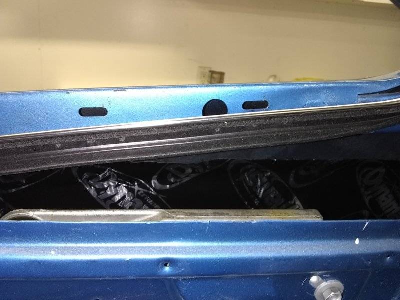

Received the cat whiskers the other day but now am looking for some instructional help in putting them in place correctly....the first time! Since they were already removed from the car when I got it, I really have no reference as to placement and how they are mounted and no type of instructions came with the package. I am hoping one of the fellow FBBO members can point me to some instructional videos or photos that can send me down the right road. I have no glass anywhere on the vehicle so that aspect is out of my way. I am assuming the glass doesn't need to be in there prior to installation of the cat whiskers? Thanks in advance. Mocajava
There are slots the tabs fit in. Don't forget the little felt piece just above the door handle on the outside.

They should be obvious after staring at them for a while. Flip them around and line the clips up with the holes, they do only go one way.
Well I fortunately saved the old whiskers (most anyway) and started on the rear quarter glass area. I elected to rivet the internal felts in place vs trying to replicate the staple scenario on the removable panel/ wing. All that went well after I realized that factory had removed part of the lower rib to allow it to bend/ curl upward. Seeing that really helped me form them and they look good.
