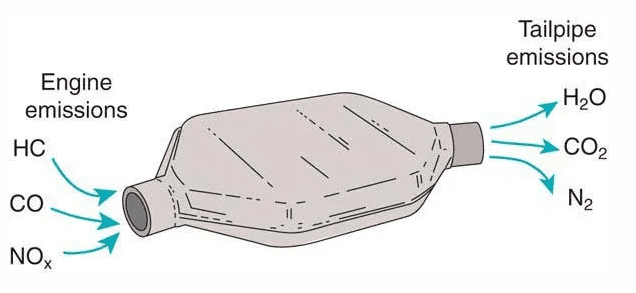

A catalytic converter converts CO, NOx and HC to CO2, H2O and N2. So if lack of these is causing you issues, that means you are reacting to CO, NOx or HC. I'm not sure if there is a way to test this before spending time and money to add catalytic converters?

I decided to look it up, since I obviously do not have a good grasp on catalytic converter details. It seems there are two kinds of converters.
Per a UTI article (What Is a Catalytic Converter and What Does It Do? | UTI): "There are two main types of catalysts that might be featured in a car:
  • Reduction catalysts: Help reduce nitrogen oxide pollution by removing oxygen. Nitrogen oxides are broken up into nitrogen and oxygen gases, which on their own are harmless.
  • Oxidation catalysts: Used to change carbon monoxide into carbon dioxide through an opposite process of adding oxygen. "
Maybe you have the reduction type on your car? Or, with respect to some of the complexities @70bigblockdodge pointed out, there was something else going on?
