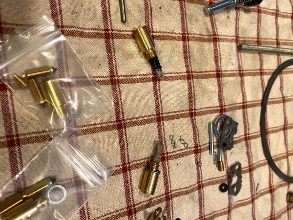

I asked for help with this problem; my 63 400 4bbl ran fine, but now periodically slows down, idles roughly, then recovers. I was advised to rrebuild the carb, which I have done for the 2nd time. I think my original hypothesis of blocked fuel inlet in the tank, or line, may be correct. When disassembling the Eddy, i found the filter screen at the inlet partly blocked by rubber-like debris. See photo.
So...should i remove and check the sending unit? Can I do this at home with a floor jack and stands?

Those needle and seat screens are part of either a Carter or Edelbrock carb - Bigger question is what are you using for an actual FUEL FILTER before your carb that all that crap is making it that far to your needle and seats ?
What type of rubber fuel hoses are you using also ? Brand of hoses
Thanks!! standard fuel filter. I pulled it and blew through it and it seemed intact, or not blocked. The tank, sender, fuel pump are all new, but the hose may be original. I agree that the fuel filter is inadequate, tho' the debris might be from the line from the filter to the carb. I suspect the sender filter, or damage to the sender that resulted in the inop gauge, as the cause of low fuel feed. What think ye? Thanks again!
yes its an Edelbrock 1407, old but very little mileage, and I installed the complete rebuild kit. Probably correctly...:(
Omit the Edel filters & use an external inline filter. Float level should be 7/16"; make sure floats are not binding...or rubbing on the side of the body.
Have you driven it again? If problem still exists, give more info.

Put a new inline fuel filter in place , I run a Wix metal canister fuel filter , get some new quality 5/16" or 3/8" fuel line rubber hose after the filter , also what’s connected at your gas tank sending unit for rubber hose
Ethanol gas today will destroy any older types of rubber fuel hoses over time
I run an Edelbrock 1406 on my 383. I have had idle issues with this carb more than a few times over the years. Idle would become erratic, I would try and set the idle but idle RPM's would be all over the place, just was not as it should be. Saw an Edelbrock video on their web site that suggested removing the idle mixture screws and blow compressed air into the holes to clear out any dirt or deposits that may have accumulate in the idle circuit. I did that and re set idle and problems were corrected. All good now till it happens again, and I'm sure it will.. Certainly do some of the other things suggested..
