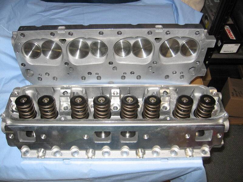

I did notice that some valves were sinking in the pockets. I plan to switch heads and do a valve job with stainless valves UNLESS I can use aluminum heads like the 440 source heads. It's not a race car. I want to keep the magnum cam specs and original look. My understanding so far is that the engine needs a higher compression to use the aluminum heads. I know the Edelbrock RPM heads are nice but they are more money and the cam doesn't need the breathing. I plan to use cast iron close chambered heads to up it a bit and use roller rockers. I never did like the stamped factory rockers. Something to fit under the stock valve covers.
Nothing set in stone yet. If anyone has any thoughts I welcome the feedback. If you use a slightly modified cam that works I'd love to hear about it.
440 Source heads are closed chamber.
Just to throw this out there....toughest thing if your looking to upgrade is parts availability, aluminum heads in particular. Edelbrock, 440Source/Stealth, Trick Flow....even the Speedmasters are unobtanium right now and the "estimated ship dates" seem to just keep getting pushed back. So if you don't want your car down for that long it might be worth considering fixing what you have for the time being.
Any particular reason?
Yeah, please elaborate. I have old 906 heads and am deciding if I want to rebuild them or just go with Aluminum aftermarket. Cost seems to lean towards AL.
I am all ears...
RGAZ
I am all ears too. The research I have performed on our forums is that the aluminum heads don't have the heat cross over for the stock choke operation.
I am leaning towards keeping the cast iron heads because I intend to keep the stock choke. It's a cruiser car.
I am looking into the cost of buying new stainless valves (I was going to purchase them anyway) & increase the exhaust valve size to match the aftermarket heads. I am dropping off the engine today and should know the cost. The builder will shed some light on this build too. I will certainly listen to their experience/feedback and share later.
