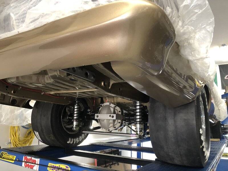

I'm not expecting to change anything given the investment I've just made, after torturing my mind (and some forum members) over asking about ladder bars, being convinced that ladder bars were definitely NOT going to work well at all for a street car, and having been "certain" I was going to install a RMS or Gerst triangulated 4 link rear suspension, I wound up using Calvert split mono leaf springs and sliders with Assassin traction bars.
Car is still in the shop, probably until at least Labor Day, so I haven't tried anything out yet.

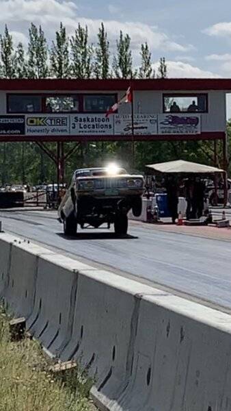

I’m curious to see how Doug’s car reacted to the change as well, with the more HP/TQ that he has. I also went up 2 holes. I found that the tires hit harder and I was getting some rear end separation. 1 notch more rebound on the rear shocks took care of that. The car wheelies more with the rear bar change and I’m controlling that with front shock rebound. Last weekend, day1, I was getting too much air and coming down right on the 60’ mark, both new bump stops were gone. I added 2 notches of front rebound to the shocks and that settled the front end down to about a 2’ wheelie. Subsequently my 60’s also dropped to 1.32. My 60’s were previously always in the 1.34 range. Of course, some pics..
Leaves nice and straight, a little too high and comes down harder than I like.

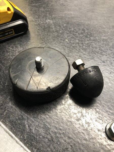

Lost both lower bump stops at the 60’ mark so had to throw in some upper bump stops for the day, that was all that I had to use. Borrowed a couple of pucks off of the grandson, will see how these work next time out.

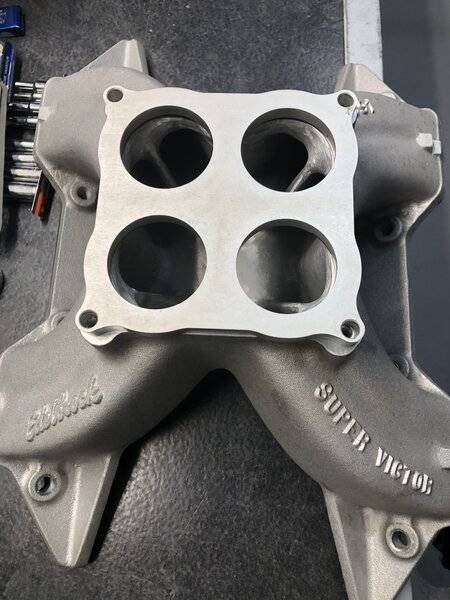

This is the .500” shear plate off of the hemi. I’m going to give it a try on the Plymouth next outing. It will replace the .500” wood spacer. During the swap the intake plenum received some additional blending for the shear plate. The Super Victor plenum was pretty much untouched, so we’ll see. ** This shear plate resulted in a 37HP increase over a 1” Super Sucker spacer on the dyno with the Hemi. We’ll see.
what brand is the sheer plate?
I think it’s a PRP plate but I’m not 100% sure. I looked at my invoice, it doesn’t say the brand but I’ll find out for you. It was one of a few plates we tried, it worked best on the hemi, it stayed put and came home. If it works good on the wedge it will stay on there and I’ll be picking up another one.
I am clueless about "shear plates" and amazed that you had a 37 horsepower increase with a part like that! I've seen spacers put atop intakes to increase plenum volume and maybe smooth out the path by "straightening" it some, but even those usually are a modest change.
They say that the way a shear plate or reversion plate works is that as the pulse comes from the cylinder (from either the valve closing, or combustion pressure coming through the intake valve) the air gets caught in the grooves in the plate causing it to turn around and head back in the proper direction. While the shear plate worked great on my 572 Hemi on the dyno it might not be apples to apples on the 505 wedge. Next time out we'll see if there's any change on the time slip.
