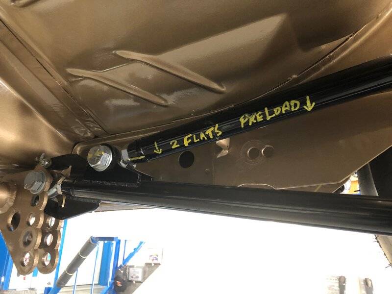

I did a check on my ladder bar adjustment yesterday and nothing had changed at all, since setting up last year sometime. My outlaw bars are adjustable on the top bars. Less driver I adjust the right side top bar so that the bolt slides freely, add 2 flats preload and lock it. Then when I’m sitting in the car the bolt slides freely.
I have the bar marked so that I don’t mess up.
