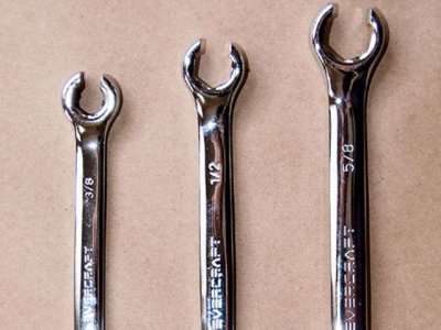

Use line wrenches for the fuel line. I made a wrench for the fuel inlet nuts that go into the fuel bowl. they always come loose when trying to remove the fuel line.

You MUST use a line wrench on the inlet nut. I've saved a few fuel lines by doing this: hold-back on the fuel line next to the nut with a rubber/plastic coated vise-grip tight but not too much. Then give the line wrench a quick abrupt whack.

If you're still struggling with it, go to NAPA and get a can of 'Fluid Film'. Spray it on the fitting and threads, tap the fitting with a hammer to set up a vibration and wait about 10 minutes. Use a tubing wrench on the fuel line nut and hold back the inlet fitting, as was already stated here. Rap your tubing wrench with a small hammer. It will come off...
