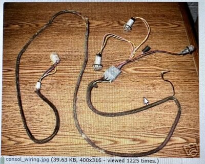

I'm thinking it should look like the long wire in the attached photo.

Classic, Year One and Dante's carry the console harness. I just got one from Dante's. The harness runs under the carpet over to the drivers harness cover under the sill plate.
Tommy white, partshound.net. good guy to deal with, knows his stuff.
Second Tommy White, i got exactly that cable from him.

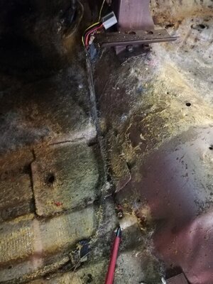

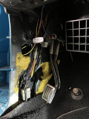

Even if I get the cable I am still uncertain where it will connect. This is what I am seeing behind the kick panel.

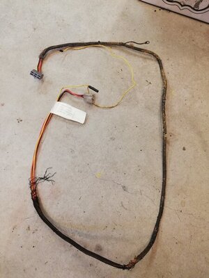

Some pics of the cable when I removed all my electrical.
The screwdriver points towards where the small ground cable is screwed down into the floor.
Im trying to remember how it was connected behind the kick panel......

There is a connecter behind the kick and then the yellow wire plus into a yellow connecter under the dash.

Let us know how it goes on your 69. Here is how it is on a 70. Every Mopar made from 1962 to 1976 has a pink and yellow pigtail coming from the main dash harness going down to the kick panel where it connects to the dome light harness. The console harness connects there. Pink is constant un-switch hot and yellow is the ground going to the door jam and headlight switches. There should be an orange wire also coming from the main harness that is from the dash lights. I seriously doubt that yours goes all the way back across the dash to the fuse block at the back of the glove box. When you pull out the wiring at the kick you'll probably see that you don't need an instruction sheet to install this simple harness.

Moparmarks, it looks like you may have spliced into the panel lights wire behind the kick panel. I see a scotch lock.
It has been a few years since I was into a 69 dash. 1970 must have been the first year that they started putting these 3 tap terminals into the dash harness. All my 70-up cars have them. An orange one for dash lights. Pink one for unswitched power and a yellow one for dome light ground. The earlier cars don't have them.
