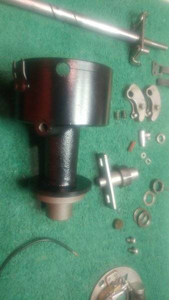

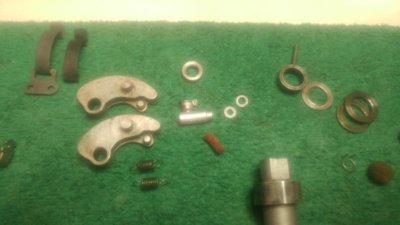

Ray, early distributors (Autolite and later Prestolite) have grease pockets in the weights (laminated type). The Autolite/Prestolite service manual talks about using a grease in those pockets. No filler type that has a melting point of 280deg F. Same goes for the cam, unless the points have a wiping wick which gets oil. As far as the pivots for the cam stop I do believe in using a thicker grease on the post for the cam stop slot. Anything to help reduce wear on the slot. This is all below the breaker plate so nothing really gets up into the points. Also, I have taken apart untouched and NOS distributors from autolite. They have a thick residual grease at the base of the distributor.
Remember your dealing with 40-50year old grease. Restored distributor with proper maintenance won't have an issue. I do agree with newer Chrysler weights with bushing not to use grease, though I use a little silicon lubricant with a drop or two of synthetic oil.
Other thing I do, especially when I repaint a distributor body is bake it at 200 in oven to dry paint and heat up bearings. I then remove the distributor and plug bottom and fill shaft with synthetic 20W oil. The absorbent bearing microscopically release oil when hot, and absorb when the cool. Manual calls for soaking them, I just do it starting hot, and let the cool in oil for a day.
