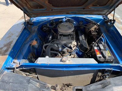

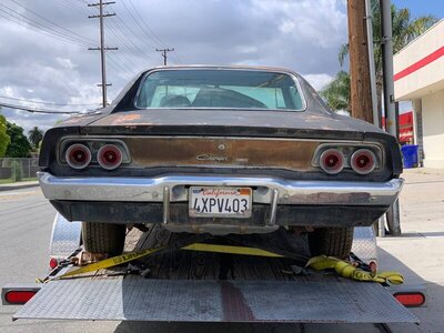

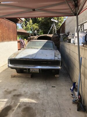

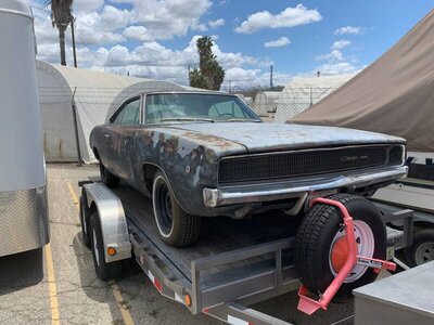

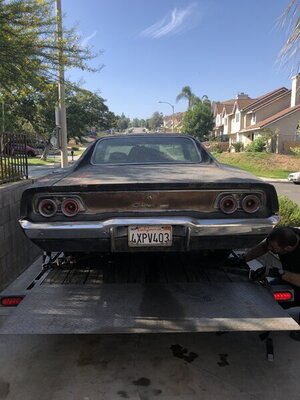

Here’s my first classic mopar and dream ride a 1968 Dodge Charger, originally a 383 Auto on the column, AC car. When I purchased it the 383 was long gone and someone had tossed in a late 70s 440. Sharing my experience during the project with the tear down and soon more install progress after the prep for it is completed.

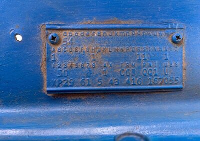

Here are shots of the trunk when I painted it. Also shot the fender tag I forgot about it when painting the first time around. Used some rust remover and cleaner on the fender tag just so I wouldn’t ruin it trying to grind paint away.
