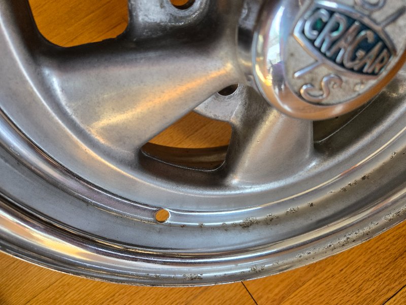

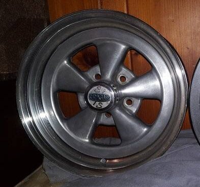

I have a set of 14" sbp Cragar Sparklers with perfect centers, rusty hoops, and have a ridiculous 4 1/16 backspace.
Need a 3.75 bs.

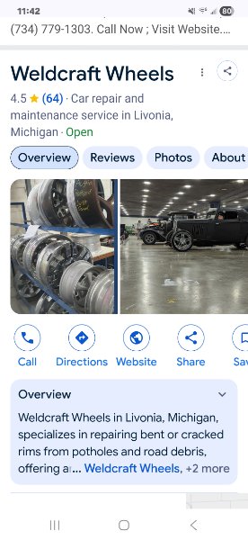

We have a local place here in Michigan called Wheel Craft that does all that kind of stuff. Widened wheels, fix damaged wheels, straightens wheels etc.

I searched "Wheel Craft" and a page comes up for a business in Mentor Ohio.
Can't seem to find one in Michigan.

Oops, sorry. Weldcraft. I had wheels in the Brian.

Steve is the owner. Good guy, good work. Hope he can help you.

I have had them repair a alloy wheel for me and they also widened a pair of steel wheels for my from 7" to 10" wide with a custom back space that I needed.
Called Weldcraft, instructed to send email, description, pics to James.

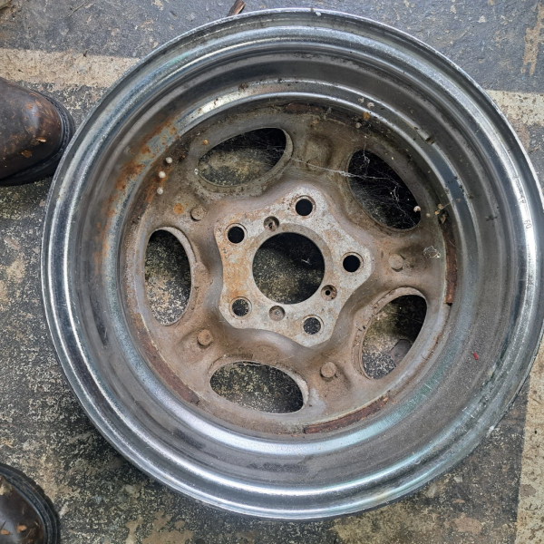

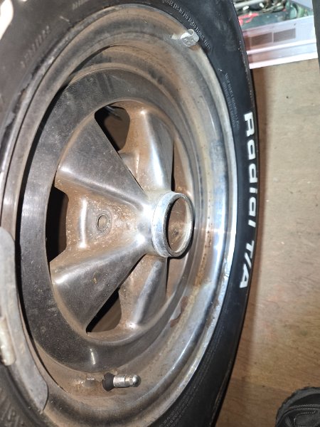

We discussed over email, moving the centers inward to a 3.75 backspace, however that's not how wheels, at least Cragars, are made.
Pics show 2 different Cragars, 2 different backspace.
The barrel has a raised section in a different location.
Obvious when looking where the center on each wheel is right up against the valve stem hole.

In the pic of the rear, you can see the five weld beads.
There are steel inserts, cast/forged into the centers.
