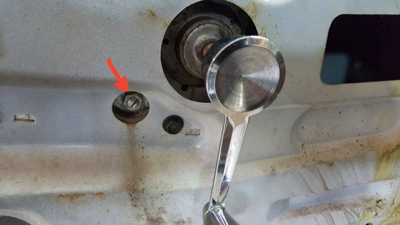

Was curious.. Can i change my door whiskers with the glass in? don't think there is enough room to get them in and out.. Remove the lower window stops, would that get it low enough? Hate those star washers that hold the glass in.. rather not fight with them :)
I know you can on an E body by removing the bottom stop, I think you can on a B body but not 100%..
Thanks... will see, if i can find a pair, they are out of stock everywhere.. It's an item i never thought much bout til my passenger glass got some nice grooves :(
Did change whisker on my 66 Satellite. They were in rough shape, some broke when pulling on them. I had to "make my own whiskers by buying long C body whiskers and moving and sealing chips. This was in 1979 no whiskers available.
Grr.. just called vans.. they have sedan and convert but no hardtop.. 4th place.. Topcat isn't making anything right now as they lost their employees...
Yes that is what I did on a 63 4 door sedan. A hardtop may be easier to manipulate and may not need to remove the stops.

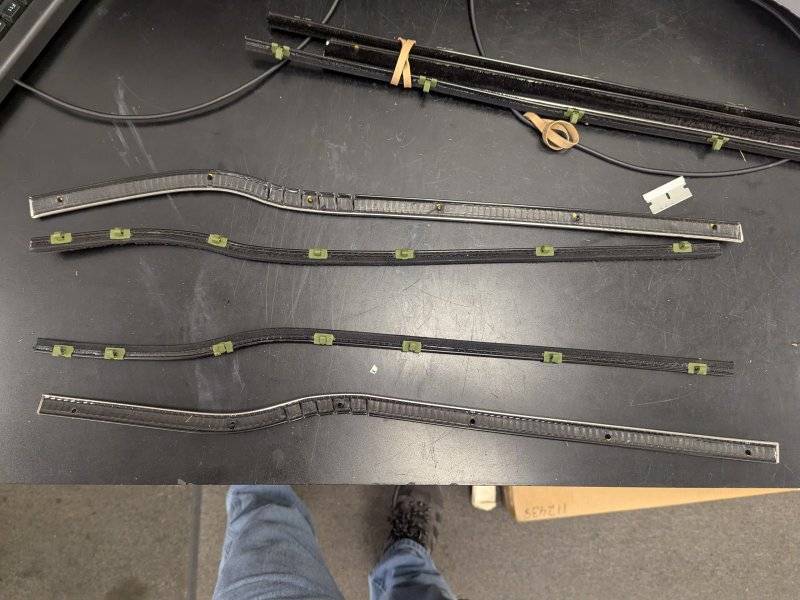

Are you using factory style with the clips ?
Ended up calling the place that makes them... Next run won't be til november.... not in a giant rush so i guess i wait :) thanks guys
