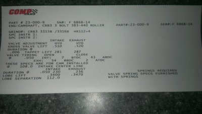

Just curious, what cam did you pick/ specs?
I am building a 440 blower motor and about the only thing I haven't, so far, gotten is the cam.

Thanks for the replies. I have another observation. The car's blower now surges . It never did that before... ever. Is that normal? I went from a larger cam to a slightly smaller cam.
I think I would ask an engineer from the cam company (and not somebody from the hotline). Did you buy an off the shelf NA cam or one designed for booosted applications?
Can timing can also make a difference in the exhaust note. One that's advanced a bit will usually idle better and sound more mild than one that's retarded a bit.
this is in reply to Badvert65 .
There are lots of folks that have varying opinions on blower cams. A good blower cam for your motor might be more like 230/240 .550 .570 on a 116LSA and a 114 ICL. Old school cam designers always think the LSA has to be 110, 112 etc. Its not best for the blower apps. Especially when the intake to exhaust ratio doesnt support it. Overlap bleeds of boost. A few degrees of negative overlap will make the car idle better, build boost faster, and hold boost better at peak.
