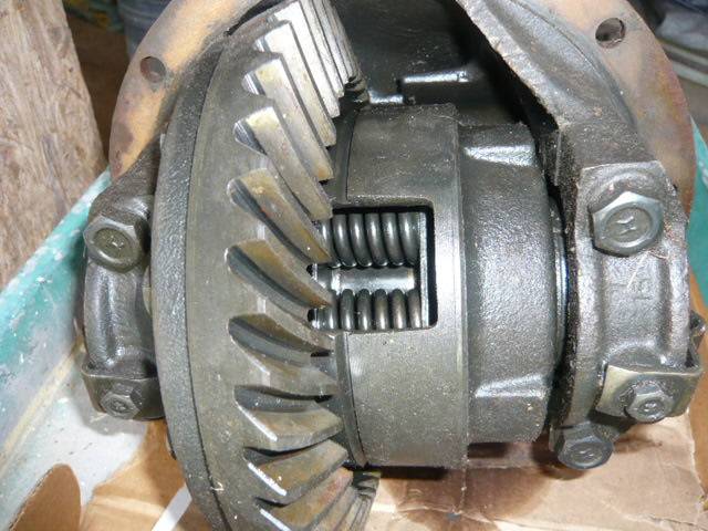

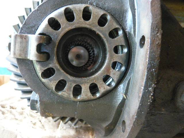

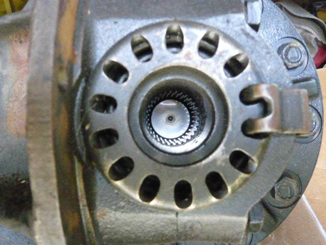

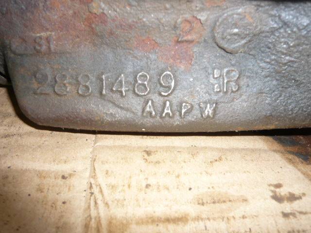

this is a 489 center ,is that a alburn unit? gears have 69 stamped on them. 70 was a changing year sooo?? its flat on the inside,it does have the large 9 on the unit
Alburn top pic. Looks like its ready to go. THE bolts to hold it together are on the opposite side on a clutch unit.

That is a cone type sure grip. The spacer is there so run it.
