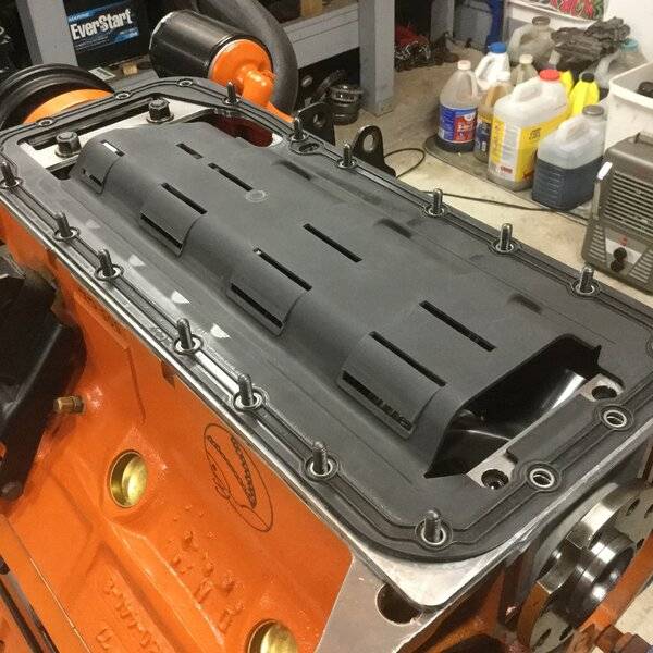

No room to put the bolt in from the top , so I will have to the same as I found it. Today I got all the old gasket material off the pan and block and also straighten out the pan flange a bit. As I mentioned I'm trying those one piece gasket/windage tray, I'm a little worried about those dimples on the pan. I'm going to verify with Summitt that it is OK to use with this type of pan.
I believe I mentioned this before, it's a good idea to add/enlarge the drainback holes, also in my case I had to cut some of the windage tray out to clearance the oil pickup tube. Mine is in an a-body so the pan is completely different.
The windage tray material is tough enough that I used some air tools to cut and shape it, just an fyi. If all else fails, you could cut the windage tray out, just spit balling here.
Also, I suggest using those bolts I posted or at least the largest washer that can fit, and avoid over torque.

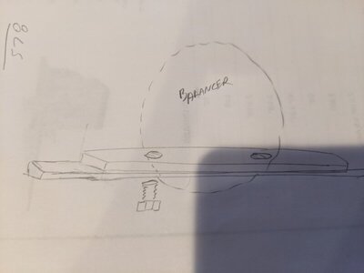

I like this, another idea would be to take flat bar and make kind of a backing plate that sits on top of the lip of the cover and has two threaded holes. The biggest problem is holding on to the nut when its in the back of the balancer. Make it long enough so it sticks out from the balancer and I could grab it. Kind of like your square nut but one piece with two holes.

Yep I was thinking this, not a fancy drawing, but were thinking the same idea, as longs as its longer so I have something to grab to center it. That will be tomorrow's job. Your idea might be easier as I wouldn't have to be exact on the measurements

Its done, went pretty well, kept the same old nut and bolt the engine builder used, wasn't bad putting them in. Now got to wait till the spring to see if it springs a leak, I'll post results next spring. I did use that one piece gasket/windage tray, what a breeze to put in. Thanks everyone for all the help and ideas. Now on to the valve covers.

Did that one piece gasket/tray look like it was going to seal around the pan indentations, or did you fill them?
I tought about it, measured many times and to me, the lips on the gasket could have been more spaced out if I had a choice. Many reviews I read people just put it on. I did check with Summitt and they said the same about the indents. So I didn't fill them, didn't know what to use first of all to fill them, I was afraid that whatever I used that it would fall apart and get in the oil. So I'm going to try it this way, if it don't work then I'll try plan B. If anything it will ge easy to take out as nothing is glued like the one I took out, it was more work to remove it than to install it.
I agree with you that those gaskets ribs could be a little further apart. I will be installing that same one on my 440 in my GTX. Just waiting for my 6 qt pan from Milodon which is on backorder.
