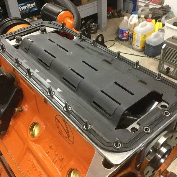

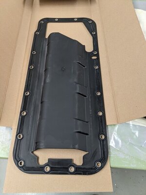

Put rtv in the cracks where the timing cover meets the block and in the back where the rear main seal holder meets the block. A dab will do. Just enough to fill the gap.
