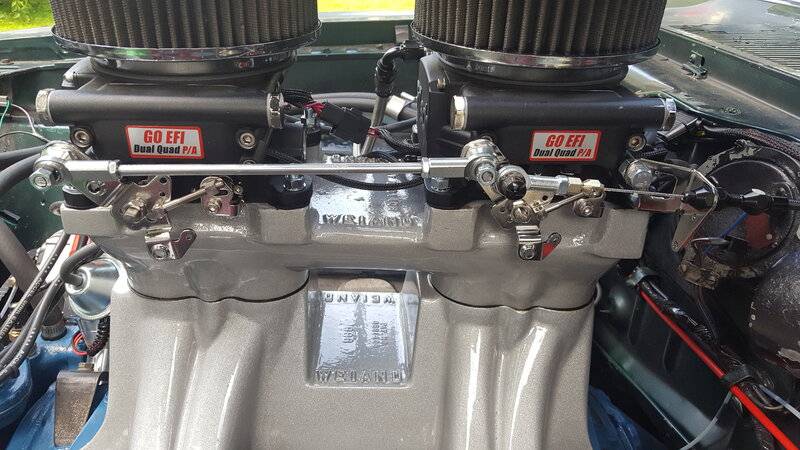

The pic is off the interweb of a mod I want to do to it.

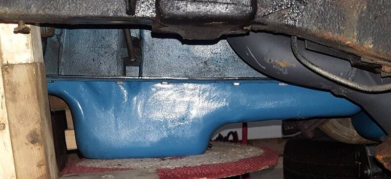

Crappy pic of the gasket installed.
It's thick, and I didn't force the bolts on, just tighten down. I believe it's crush proof around the bolts.

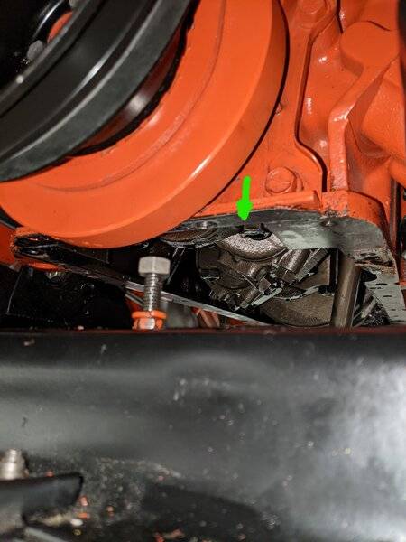

Ok got the oil pan off without damage, had to use a sharp putty knife and hammer and go around the pan. Now I have two questions,
1. in the pic i posted the green line points to what appears to be a spacer, do i remove that and reseal it? or maybe it does not come off, I'ver never done this before.
2. see the bolt and nut on the kframe, the enginve builder had them in the two center holes on the front of the pan. I somehow think that is not original. Is the timing chain cover supposed to be treaded. I had a hell of a time getting those off as its behind the balancer. I'm guessing the threads are damaged so he came up with this rather than fising the cover properly. If I'm correct any suggestions on how I can fix this, I can see a lot of swearing putting those back in there.

There are no spacers, just the pan gasket. The front 2 holes should be threaded in the timing cover.
Like mentioned by blk 68
That’s not a spacer , it’s the sealing surface of the timing chain cover for the oil pan and gasket

He had nuts on the backside of those two threaded holes ?
Then yes , maybe those threaded holes are stripped out in the timing chain cover
How deep you want to dig in ? Like replacing the timing chain cover yes or no
Scrape off the old gasket and put it back together the way you found it. (With a new gasket of course)

Yep, he had nuts there, I don't want to replace the timing chain cover, just got to come up with a way to hold those nuts in place while inserting/getting the bolts started, once I get it started I think I'm good.
It might be easier just to drill and tap those out to 3/8"

I would love to be able to drill and tap but then engine is still in the car, no room. I will try putting the bolt in from the top, not sure if there is enough room but that would be better. I was also thinking of jb weld the nut on top of the timing cover, but I think I would have to remove the balancer to gain access in order to do it properly. I wish my engine builder would have told me about this I would have told him to change it.
