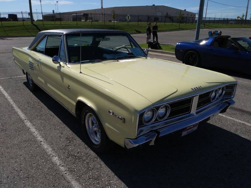

...maybe! I've owned my '66 Coronet since April 1980, and am the second owner. I'm thinking about going a new route on my car. It's fairly stock with the original 361 built to 383 specs, with a 3.23:1 SG rear. It was painted Daffodil Yellow from the original Cream way back in 1970, and I kept the yellow in 1985 when it was repainted again...here is what I'm considering, not to seek approval or any of that, just tossing around a few ideas that came down to this:
Repaint black, retaining the vinyl top and all stock trim. Power would be from a 5.7L or a 6.1L Hemi, with the automatic transmission. Interior would remain stock, other than a well-hidden stereo with Bluetooth system installed. Wheels would be like what is on it, but in a 17" or 18".
That is what I have in mind, so far. It needs very minor rust repair in a few small areas. I'd probably install new door cards and carpet, along with repainting the upper and lower areas inside the doors.
I'd do all the teardown, and haul the roller to a fantastic local Mopar racer and restorer to do the paint and drivetrain. I'm looking to get this completed by April 2020, my 40-year anniversary with the Coronet.
Anyone with actual experience with drivetrain swap out there??? Any ideas or experiences you've had with this swap are appreciated!
My theory about all this is simple...it's my car, and I'll die one day, still owning and driving it up to that point. It'll never be a huge$$$ car, and that's fine. I want to make it what I want. A new black car is common. A black '66 is not.

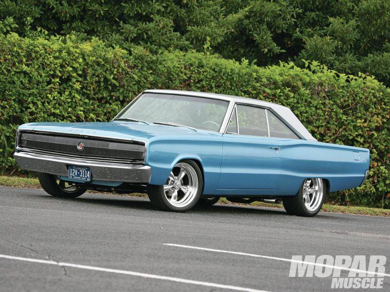

If you really want to go a new route for your car --- put a 66 Charger grille in it. That will make some heads shake.

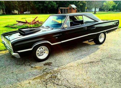

Mine was already black, head turner for sure. Bought it from my dad and tore it down to make it what I want. Didn’t go modern drivetrain so I have no input there but if budget allows do it!

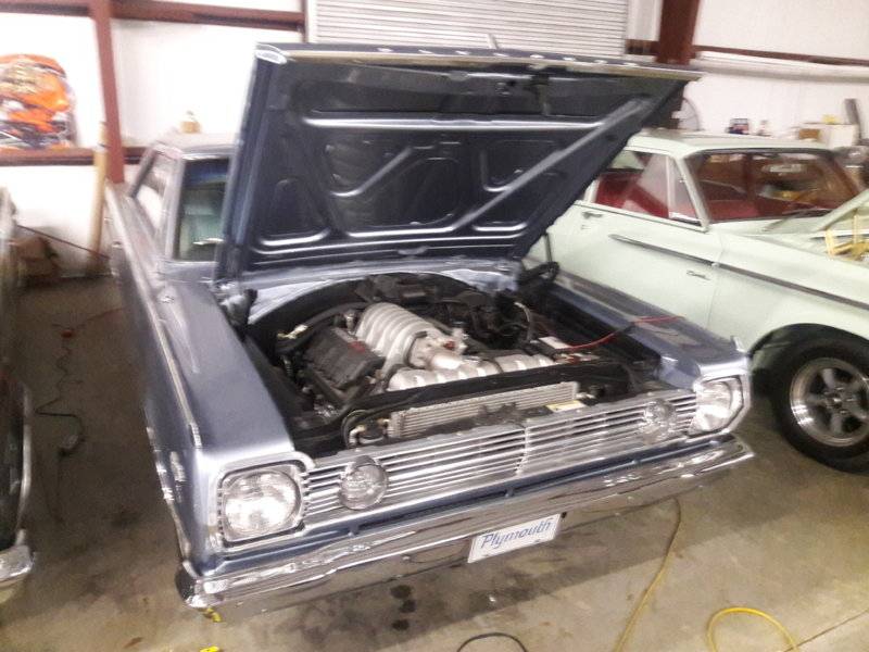

I like Black, the blacker the better. Today the Gen III Hemi swap is no big deal with the plug and play stuff from Chrysler. All modified parts are now available from many vendors. I have 2 modified cars that were done the hard way. Hand fabricated motor mounts, cross members, custom headers, and reprogrammed Chrysler computers with custom harnesses. I kept original K members of both, notched for A/C compressor clearance on the air car.
Car #1 Car #2
67 Satellite 66 Satellite
5.7 Gen III (2012 with 12 miles) 6.1 Gen III (2010 Crate Motor)
Tremec 5 Speed 727 Small Block Automatic Upgrades for up to 600 HP
3:23 Sure Grip 3:55 Sure Grip
Frame Connectors Suspension Upgrades in Progress
Disk Brake Conversion on Front Gear Vendors to be added
Front & Rear Sway Bars
Numerous Suspension Upgrades

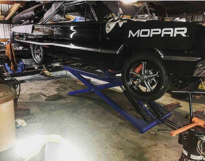

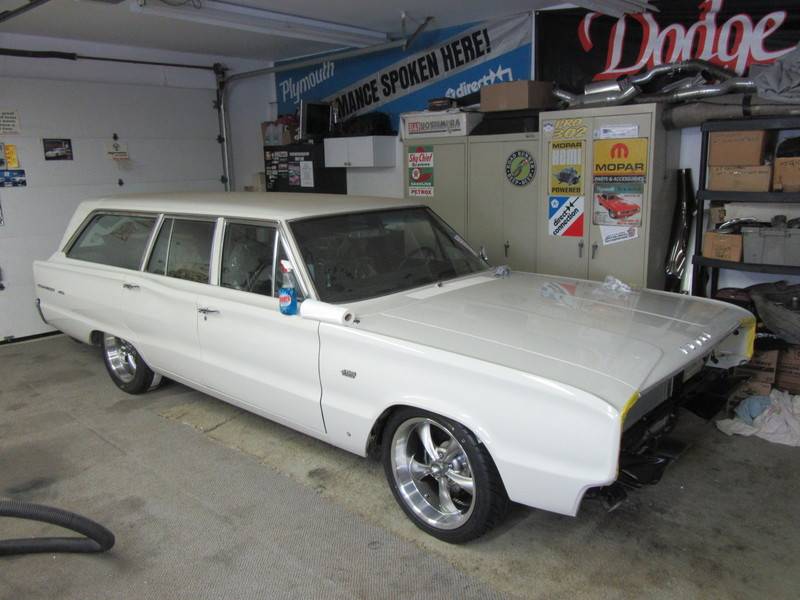

In process on the grill swap, on my old car.........
