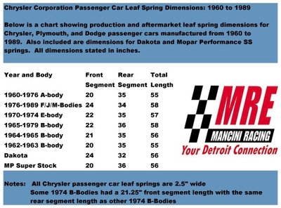

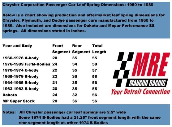

maybe this chart will afford you the information to make a decision....
